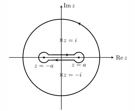

What you need here is a dog bone contour.
Let $\Gamma$ be the circular contour and $\gamma$ be the dog bone. On the bottom part of the dog bone, we get the negative of the square root and a negative for the direction.
\begin{align} 2\int_{-1}^1\frac{dz}{(z^2+1)\sqrt{1-z^2}} &= 2\pi i\sum\text{Res}\\ \int_{-1}^1\frac{dz}{(z^2+1)\sqrt{1-z^2}} &= \pi i\sum\text{Res} \end{align} where the residues are at $z=\pm i$. By the estimation lemma (see your other post on branch cuts), as $\epsilon\to 0$, the integration of the small circles go to zero and the integral of $\Gamma$ is zero as $R\to\infty$. Now evaluate the residues and you are done.

To add some detail, (u line is the upper line of the dog bone and l line is the lower line) \begin{align} \int_{-1}^1\frac{dz}{(z^2+1)\sqrt{1-z^2}} &= \int_{\Gamma}fdz + \int_{\gamma_1}fdz + \int_{\gamma_2}fdz + \int_{\text{u line}}fdz - \int_{\text{l line}}fdz\tag{1}\\ &= \int_{\text{u line}}f(z)dz + \int_{\text{l line}}f(z)dz\tag{2}\\ 2\int_{-1}^1\frac{dz}{(z^2+1)\sqrt{1-z^2}} &= 2\pi i\sum\text{Res}\\ \int_{-1}^1\frac{dz}{(z^2+1)\sqrt{1-z^2}} &= \pi i\sum\text{Res}\\ &= \pi i\biggl[\lim_{z\to i}\frac{(z-i)}{(z^2+1)\sqrt{1-z^2}} - \lim_{z\to -i}\frac{(z+i)}{(z^2+1)\sqrt{1-z^2}}\biggr] \end{align} The last integral in (1) is subtracted since we pick up the negative from the square root in the lower half. In (2), the integral is now positive due to the negative from the direction of motion. As $R\to\infty$, $\int_{\Gamma}\to 0$, and as $\epsilon\to 0$, $\int_{\gamma_1,\gamma_2}\to 0$.

I am still having trouble at finding residue at -i. My work is like this $a_{-1}(-i)=\frac{1}{\sqrt{2}.2e^{i3\pi/2}}$, but there is mistake in here and I haven't been able to figure it out. – Roshan Shrestha Nov 18 '14 at 16:06
In my diagram of contour, there is no dog bone like structure, but the branch cut extends from -1 to 1 – Roshan Shrestha Nov 18 '14 at 16:07
1@RoshanShrestha that is a branch cut. The dog bone goes around the branch cut. You see in the diagram on my post the $-a$ and $a$? Consider that $-1$ to $1$ branch cut would connect them the dog bone goes around it. – dustin Nov 18 '14 at 16:21

Now using the dogbone contour shown in the accepted answer and traversed counterclockwise we pick up $2Q.$ This is because for $x\in(-1,1)$ we get above the cut the value $$\exp(-1/2\log (1+x))\exp(-1/2\log (1-x) -1/2\times 2\pi i) = - \frac{1}{\sqrt{1-x^2}}$$ and below the cut $$\exp(-1/2\log (1+x))\exp(-1/2\log (1-x)) = \frac{1}{\sqrt{1-x^2}}.$$
Therefore $$ 2Q= -2\pi i \left(\mathrm{Res}_{z=i} f(z) + \mathrm{Res}_{z=-i} f(z) + \mathrm{Res}_{z=\infty} f(z)\right).$$
