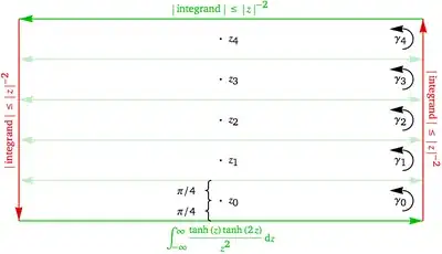

By symmetry, we have $$\newcommand{\Res}{\operatorname*{Res}} \int_0^\infty\frac{\tanh(x)\tanh(2x)}{x^2}\,\mathrm{dx} =\frac12\int_{-\infty}^\infty\frac{\tanh(x)\tanh(2x)}{x^2}\,\mathrm{dx}\tag1 $$ There are singularities at $z_k=i\pi\frac{2k+1}4$ and $$ \Res_{z=z_k}\left(\frac{\tanh(z)\tanh(2z)}{z^2}\right)=(-1)^{k+1}\frac{8i}{\pi^2(2k+1)^2}\tag2 $$ Sum over the telescoping paths $$ \gamma_k=\color{#090}{\overbrace{\left(-R+i\pi\tfrac k2,R+i\pi\tfrac k2\right)}^\text{these contours telescope}}\cup\color{#C00}{\overbrace{\left(R+i\pi\tfrac k2,R+i\pi\tfrac{k+1}2\right)}^\text{these integrals vanish}}\cup\\ \phantom{\gamma_k}\color{#090}{\left(R+i\pi\tfrac{k+1}2,-R+i\pi\tfrac{k+1}2\right)}\cup\color{#C00}{\left(-R+i\pi\tfrac{k+1}2,-R+i\pi\tfrac k2\right)}\tag3 $$ where $\gamma_k$ contains $z_k$.
The sum of the residues in the upper half plane times $\pi i$ will be the integral on the half line: $$ \begin{align} \int_0^\infty\frac{\tanh(x)\tanh(2x)}{x^2}\,\mathrm{dx} &=\pi i\sum_{k=0}^\infty(-1)^{k+1}\frac{8i}{\pi^2(2k+1)^2}\tag4\\ &=\frac8\pi\sum_{k=0}^\infty\frac{(-1)^k}{(2k+1)^2}\tag5\\[3pt] &=\frac{8G}\pi\tag6 \end{align} $$ where $G$ is Catalan's Constant.
