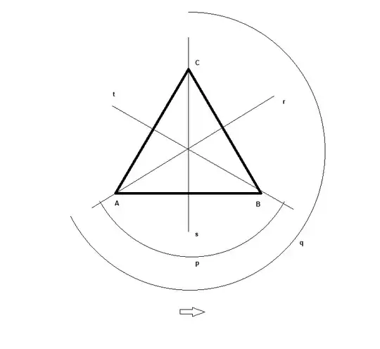

But of course we want to prove associativity without referencing wiki. I think the simplest way to do this is to create the Cayley table of the symmetric operations of the equilateral triangle. This can be done rather quick.
The reflection $r,s,t$ and the (counterclockwise) rotations $p,q$ are drawn in the sketch. The identity transformation is not shown. You have to check all 36 combinations. As an example we calculate $r\circ s$, to reflexions, will result in a rotation. Wich one? $s$ does not change $C$, but $r$ transforms $C$ to $B$, $q$ also transforms $C$ to $B$, so $r\circ s = q$. Doing this for the whole table we see that the table represents the binary operation $x\circ y$, where $\circ$ is the composition of function. We know that the composition of function is an associative operation, so our table is associative.
