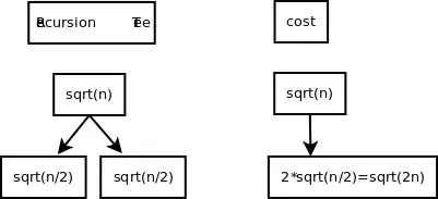

This was an image that one of the replier's had:
From the recursion tree, I get that the recursion is $\sqrt{n} + 2\sqrt{n/2} + 4\sqrt{n/4} +...$
Reduced it becomes $\sqrt{n} + \sqrt{2n} + \sqrt{4n} +...$
I'm pretty sure this summation happens log(n) times, which would make the equation be:
$$(2) \quad T(n)= \sum_{k=0}^{log(n)} \sqrt{2^kn}$$
Now I have no idea. I don't know how to solve a sum with log(n) bounds or if this is even set up right. How do I get from #2 to #1?

I don't think your solution to the recurrence is quite right, though it is close. But to answer your main question, note that you can write:
$$T(n)= \sum_{i=0}^{log(n)} \sqrt{2^i n} = \sqrt{n} \sum_{i=0}^{log(n)} \sqrt{2^i} = \sqrt{n} \sum_{i=0}^{log(n)} 2^{i/2}$$
Note that this is a variant of the well-known geometric series. You might not know its closed form, but we can derive it easily. We will derive a general result, as follows:
