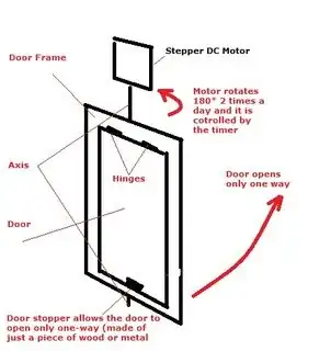

Build a door similar to this on the picture below;
It is similar to the small doors for pets found on exterior house doors. I am not sure if the chickens will push the door with their heads to enter inside or go out. If this is the case, then you can put a sensor and a second stepper motor to open and close the door. Don't forget to wire the sensor also to the timer.
I bought one of this timers to use with my boiler. They are around 15-20$ on aliexpress. For the stepper motors, look inside of the old CD/DVD ROMs or Scanner / Printers. I don't think they are expensive. I think you can find sensors online. They must be cheap on sites like ebay or aliexpress.
Note: You may ask how to limit the rotation to 180*. Well, it may be done by setting the speed of the motor. The timer is not second-sensitive. The minimum time range between the On and Off is 1 minute. So the door should complete the 180* rotation in one minute. I know it is not easy to do without using electronics.
