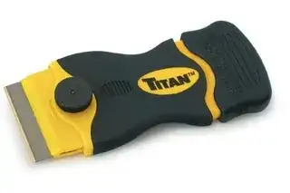

A razor blade at a low angle should work. I use the kind in the link below to change my windshield stickers (along with Goo Gone). They apply the same principle for fixing chips in a windshield (filling it in with an adhesive then scraping it off).
Titan 12031 Mini Razor Scraper
