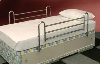

You can use a bed rail, which is a board or rail mounted on the side of the bed frame. Think of it as a removable headboard for the sides of the bed.
Here's a general purpose one that you can buy commercially:
Alternatively, you can make your own pretty easily. Just get a board of wood and prop it between the side of the mattress and the bed frame.

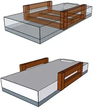

For very cheap (like possibly under $30), if you already have a drill and saw, you could simply use some 2 x 4's, screws, and create your own railings.
Depending on size of bed this would probably take anywhere from 4-8 8ft 2x4's and at least 14 screws (or I guess even wood glue could work so no screws or drill needed).
The 3 horizontal 2x4's that connect the side rails to each other would be placed between the mattress and the bed bottom. I don't think there'd be much comfort-ability issues with this as long as the mattress is decent enough.
You'd want to make sure that the side rails are pretty tight/close to the mattress on each side, so not much any room for sliding issues.
You could even paint/stain/finish the piece to make it look however you prefer.
