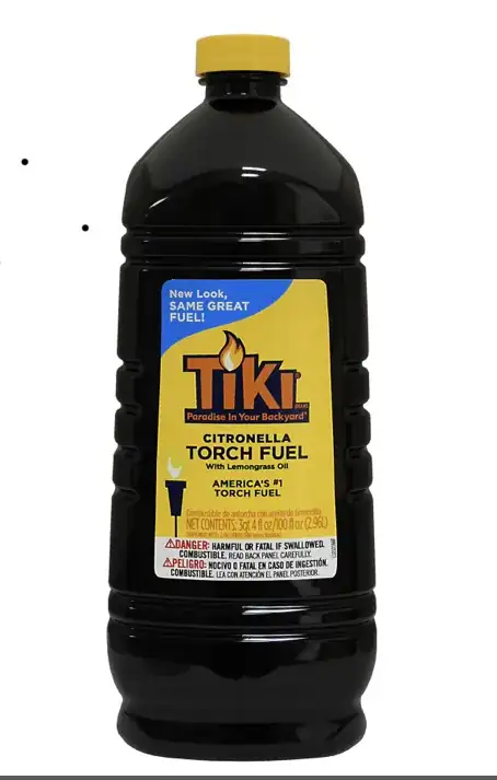

I have the solution.
After much trial and error using MANY products including but not limited to, Dawn dishwashing liquid + hot water (works on vinyl coving mastic), Goo Gone (both types), acetone, Pinesol, and a number or other products, here is what worked without removing the stain on a pine frame:
TIKI TORCH FUEL
It worked perfectly and left the stained wood intact. It also worked on a painted aluminum surface without damaging the pair. A real miracle. TikiTorchFuel
