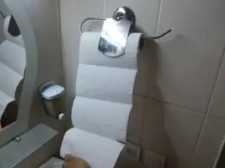

I work in a workshop, and share toilets with 25+ workers. When they dispense paper towels the roll keeps spinning and some paper towel is wasted when it falls to the floor (5 or 6 squares at a time). So, we need to buy paper towels a lot to keep in stock.
I was planning to use a spring to hold a metallic piece against the paper towel to keep it from spinning out of control, but I am not sure because this isn't so original and may be a bad idea.
How can I decrease the waste of paper towels in the bathroom? (Without Electricity!)
toilet paper This is very bad :(

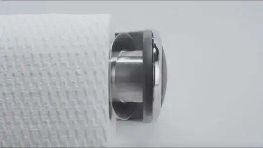

This has a built-in tension spring to get around just this problem. As you can see from the image below, the disk on the side of the roll adds tension and keeps the roll from spinning endlessly.
http://www.amazon.com/Simplehuman-Mount-Paper-Holder-Stainless/dp/B002YI653C

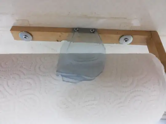

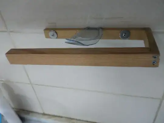

Me and my friend have been found a solution. The way is very basic and economical. The plastic spare is a part of 19LT water bottle. With only 8 screws, we can bring three woods together and put some glue for making strong each other. Now, nobody can hold lots of towel, it is limited by the plastic part.

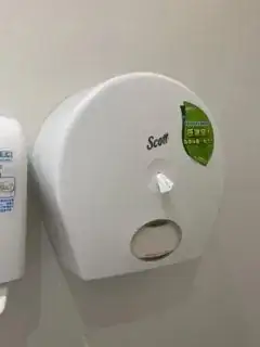

You can also ask owner of the place (or whoever responsible for the toilets themselves) to buy and install such a dispenser:
Toilet paper dispenser with hole in the middle
The paper comes out of a small hole in the middle, one in a time, so there's no waste. I have this in my own workplace for several years now and it's really good, though sometimes the paper get stuck.
