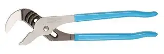

Or use the longest channel locks you can find and rip that sucker off.
