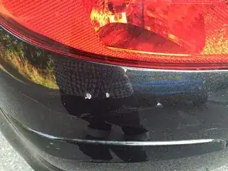

What can I use to protect the scratched part from getting rusty? I am seeking a temporary solution for a week or two till I have the time to take it to get repaired.

The damage pictures appears to be on a bumper which is made of ABS plastic and therefore won't rust.
If it were a metal panel, a temporary fix is a dab of nail varnish.

  • Curious here, how can you determine that? – Anubian Noob Jul 12 '15 at 01:44
    That picture appears to be the rear of the vehicle, just under the tail light. Look at how the rub strip is moulded into the panel and how the panel bends around the car. Very cheap and easy to produce in impact plastic, very expensive to produce in metal. – Steve Matthews Jul 13 '15 at 08:54
