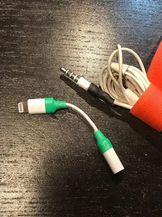

Either use magnetic connectors (which in effect are similar to Apple’s magsafe system): mag
or, to really fortify, use heatshrink tubing on a thin layer of hot glue: hst
You need 10 or 15mm heatshrink tubing. When you heat it over the glue, it creates a strong bond that will require some effort to break.
