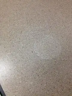

I moved into an apartment with new counter tops. I'm not sure what type they are, but I think they are formica. They also said "glaze." Which I'm guessing is some sort of laminate?
Anyways, someone put a hot cup on the counter and it left a white stain. It isn't too bad, but my apartment will make me pay for it. Any way to restore it? Thanks!

I have a cheap laminate worktop, the colour of light beechwood. I've tried virtually everything to remove some light coloured heat marks. These could only be seen in certain lights (ring marks, spots, streaks) and not at all when wet. Tried toothpaste, with maybe a slight improvement. So I went all gung ho on it with Ajax scouring powder, going over the whole area about 2ft x 1.5ft, using medium pressure. I'm very pleased with the result. Even my husband noticed. I assume that the Ajax has taken some of the shine off the whole area so that the damaged areas do not show up nearly as much. Very pleased.

It depends on how deep the burn is and what material the worktop is.
Looking at the image it's not too badly burned. A good test is to wet the burned area with water. If the mark disappears then it's likely easily repairable, otherwise it might require a more substantial approach.
Not 100% clear from the image, but it seems to be a basic kitchen worktop - laminated/veneered chipboard/particleboard.
