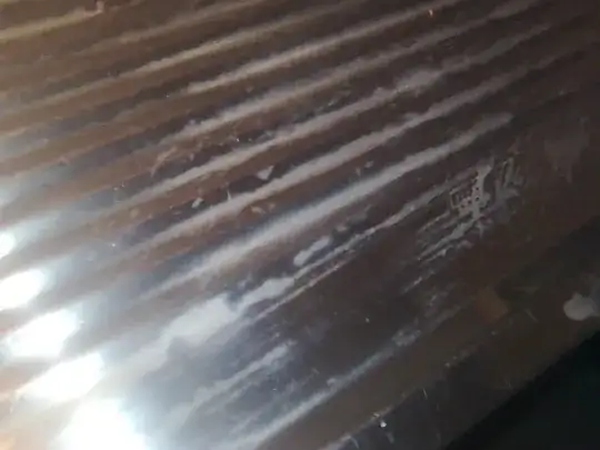

I used hydrochloric acid to remove calcium deposits from a pot, but left some of the acid on the kitchen sink metal plate overnight. It produced corrosion stains like on the photo, that can't be washed away. Is there a way to remove the stains or make them less visible?

  • Hydrochloric acid will eat through metal. It is used to etch circuit boards. It does so very slowly which is why it did not damage the pot, but the plate with was exposed overnight was not so lucky. I imagine the stuff is not that eatable either so I would stop using it on dishes. –  Apr 14 '15 at 18:03
    Best use citric acid to remove the residues. It's not as agressive. – Julian Apr 15 '15 at 08:56
    Use white vinegar to remove calcium deposits on materials near food and food preparation areas. It works and is not toxic. Treat heavy deposits repeatedly. – Stan Jan 14 '17 at 03:55
Since it's actually etched into the metal, you'll need to buff the sink to a consistent finish. One method, assuming it's a stainless steel surface, is to use a mild abrasive with oxalic acid, such as Barkeepers Friend and clean and abrade the entire sink with a sponge or cloth. This will require a lot of rubbing.
If that does not produce a consistent finish, abrasive grits can be used, starting with a moderately coarse (low number grit) and finishing with one that gives an even matte appearance.
Do not use steel wool, which inevitably leaves embedded fragments that rust.

I had the same problem - the stains on my stainless steel sink were caused by pool acid. I used Brasso and the stains are completely removed.
  • Please add some explanation to help OP out. As it stamds currently, it more looks like a comment. – A J Jan 15 '17 at 05:05
I have just buffed out hydrochloric acid stains in my kitchen sink using a car cutting compound with the aid of a felt pad on my Dremil rotary tool. It has come up very well, hopefully my wife will only comment on how shiny the sink looks!
