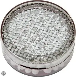

At most bike shops here they sell this:
It is like a box with small very light balls in them. Just move it along the tire and the balls will start to jump at the hole

  • Welcome to Lifehacks.SE! Product recommendations is a controversial topic on Lifehacks meta. But since you don't recommend a specific model/brand I guess it's ok. Could you please add the name of this thing or how you could make one yourself? – Alex Mar 12 '15 at 08:52
    Well in Dutch it's called a "lekzoeker" which translates to "leak finder" or "leak detector". I couldn't find any english websites that have it so maybe it's just a Dutch thing. But even here not many people have it I think. It's not that popular I guess. No idea how you could make it yourself. – Ivo Mar 12 '15 at 08:58
    @Alex - this is an excellent example of where a product recommendation is a good thing -- I've been biking for decades, and have never seen or even heard of such a device before, so I'm sure that many people have no idea that such a thing exists. – Johnny Mar 13 '15 at 18:51
    I signed up just to say that this is genius, should be allowed on the site, and I've never seen one in England.
    I imagine you could put one together with a spent metal mint tin, a drill, and some polystyrene balls (excuse to fire up Amazon*!). Just make sure the holes are smaller than the balls (duh) - I reckon you'd be able to feel them move; get away without the transparent tin.
