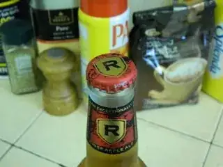

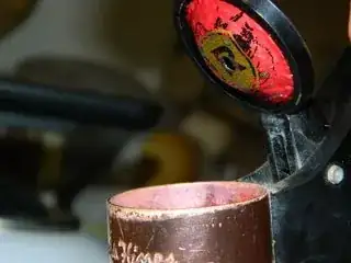

You can fix this with a bottle cap and some common tools. First bend the bottle cap with pliers (you can also use a hammer) so that the sides are up. Now use sandpaper to get the bottle cap round. Now drill a hole in the middle of the bottle cap. You should be able to just wedge the bottle cap in the spout cover, but if you can't, you can always use glue.
Here's some good photos showing how to build the bottle cap cover
Source: Instructables
