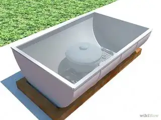

Method 2: Heavy Duty Solar Oven
  1. Cut a large metal drum in half vertically with a jigsaw (e.g. oil drum).
  2. Clean the inside of the half-drum thoroughly with a de-greasing soap (use a scrub brush).
  3. Size and cut three pieces of sheet metal to contour to the insides of the half-drum. You need one large rectangle for the curved interior and two half-circles for the end pieces.
  4. Attach the sheet metal to the inside of the drum.
  5. Paint the inside of the oven with a reflective paint rated for barbecues.
  6. Create a continuous metal lip around three of the four top edges of the oven. This will hold the glass top (which you will slide in and out through the fourth, open side) in place.
  7. Flip the half-drum over and apply spray-on insulation to the outside walls.
  8. Attach a base to the bottom of the oven (ex. a piece of wood, a square aluminium frame with wheels, etc.).
  9. Drill drainage holes in the bottom of the oven. This will allow liquefied steam that drips down the sides to escape the oven.
  10. Slide a custom-sized sheet of tempered glass into the metal lip.
  11. Insert a magnetic thermometer.
  12. Place a thin aluminium grill along the bottom (optional).
  13. Test your oven’s heat capacity on a sunny day. Though you can reasonably expect a max heat of between 250 and 350oF (90 and 175oC) depends on the size, materials, insulation and weather.
