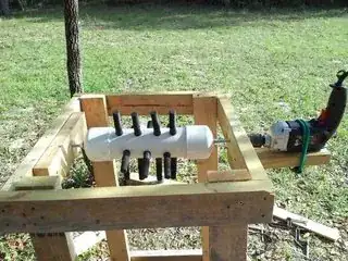

The automatic chicken pluckers you referenced are generally used in conjunction with scalding. I'm not sure how well they'll work without scalding, but I knew a friend who got by with the following set up:
  • Scald (maybe optional?)
  • Use a homemade plucker hacked together from a corded drill, a 4" PVC pipe, and 4 of the rubber fingers used in the automatic pluckers.
The homemade plucker was assembled by drilling 4 holes at 90° each around the circumference of a short length of 4" diameter PVC. The rubber fingers were inserted in these holes, to form an "x". Then it was attached a cap to one end with a bolt inserted through the center and chucked up the bolt in the drill. Then the drill can be zip tied to a table or bench, and the trigger can be zip-tied down to keep it running.
Be warned, it will send feathers flying EVERYWHERE!
You can see a souped up version of what he used in this picture:
(Image Source)
