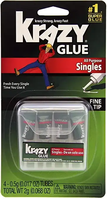

I've solved this problem by getting the 4-packs of single use super glue.
krazy glue singles
I don't need this type of glue very often, and it is great not to have to worry about getting the tip back on after you are done.
