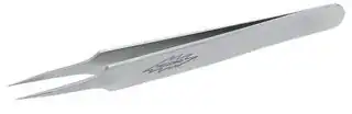

I'd suggest using a pair of thin tweezers, like these:

  • @Shoket , yes I tried it but it seems to be stuck quite tightly, and I am afraid to damage USB port itself. Should I bring it to the Sony Centre? – Win.T Jan 26 '15 at 05:57
