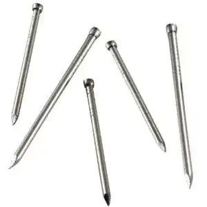

Two finishing/trim nails could work. Hammer them in close together (horizontally spaced) so the cable just fits between the nail heads. Most (micro) USB connectors shouldn't be able to slip through, and the cable will just dangle there. I recommend finishing nails because they have thin heads, but any nails that you can put close together (while keeping a small space between the heads) should work.
The headphones simply hang from the nails themselves. If they are prone to slipping off, you could angle the nails a bit upward to create more of a "hook".
If you're not sure what finishing nails look like:
nails!

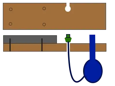

If you are not afraid to drill a hole and use a saw I got a suggestion for you: Build your own headphone stand out of a piece of wood and drill a hole for the charging cable. Attach under your desk. Here is an image with the top view and side view of my suggestion:
Building instructions and/or description of stand:
  • Use a suitable piece of wood (brown in image), and drill holes for the screws on the left hand side (black circles)
  • Drill a hole (white circle) just on the outside of where it will attach to desk the size of your charging cable, but not larger than the head of the cable
  • Use a saw to finish the split into towards the hole. The cable should easily slide in through the slit
  • Optional: Make a little recess at the end of the slit, so that the head of the charging cable (green) could slip a little beyond the top of your wood piece so as not to slide out
  • Optional: If don't like the sharp edges where you hang your headphone you could taper or round off the edges in that area
  • Attach underneath the desk, and hang your headphone and/or charging cable to the stand

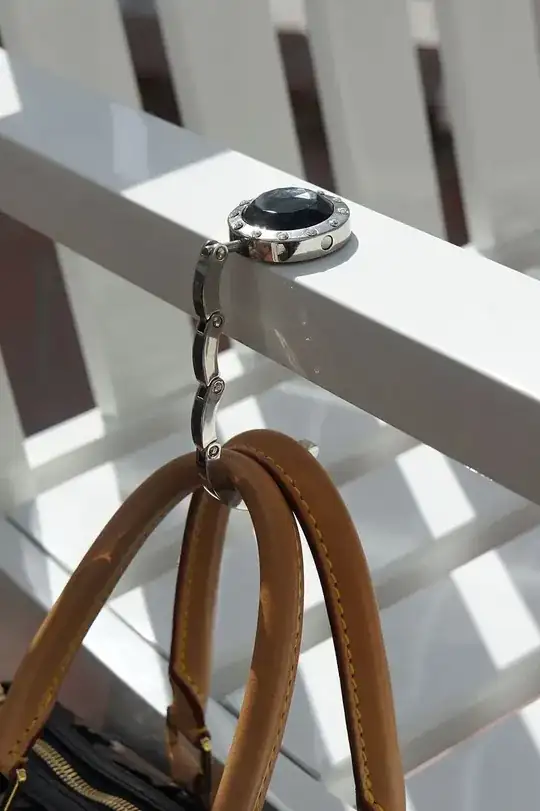

I would recommend a handbag/purse hanger and a paper clip.
Basically just place the unfolded hanger onto the table’s edge, hang up your headphones. No holes, no damage, can be moved as needed.
You can slip a paper clip on the hook part and use it to hold the cable. It can easily be bent a bit so that it prevents the cable from dropping and still be removable, if needed.
