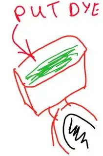

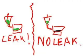

As lifehacker mentions, you can check if your toilet tank is leaking in this way (essential info):
  1. Put some dye, e.g. green one (anything coloring) in the toilet tank
  2. Don't flush, wait for some time.
  3. If in the toilet bowl you see colored water, your toilet is leaking, otherwise it doesn't.
That's if the leak is small. If it is big, you can detect it just with your eyes :D

  • 1+ This seems like a awesome method. Could you add some pics perhaps to show us what it is suppose to look like. And couldn't rust water look like the dye? These are just some suggestions. Thank You for your contributions and I hope to see you around! :) – Pobrecita Jan 11 '15 at 00:03
  • @dar made an edit. – nicael Jan 11 '15 at 07:22
  • I saw. Great job! Only I already upvoted :) Hopefully now this answer will get the votes it deserves. – Pobrecita Jan 11 '15 at 07:23
