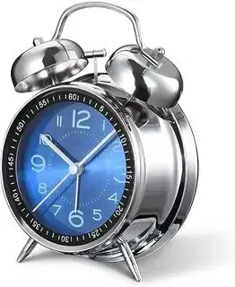

Is there a cheaper product
Yes there is:
no electricity alarm clock
This is alarm clock that works only on battery, and not dependent at all on electricity. And it makes lots of noise, had it many years ago and it can awake anyone and anything.
From quick look, on Amazon it costs $18 which is cheaper than what you have/found.
