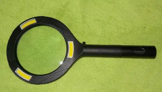

It runs on two AA batteries and the switch is dirty so the LEDs flicker. It has no identifying/manufacturer marks anywhere...including inside the battery compartment. I'm loath to pry it apart lest I ruin it
    if u r sure the flickering is due to the switch there's some chance (little) you can clean it either by an electric contact cleaning spray (if u have access to) or just by spaying rubbing alcohol from the switch gap and body, then switching on/off for a minute and letting it dry. Check the battery contacts also. IMHO if u c some screws then it would be way better to open it and have it throughly clean. what I would do (i don't recommend tho, only if I couldn't get in), a good spray in the battery cmpt and switch, a good shake, rinse, and waiting a few hours to dry. – user174174 Mar 28 '23 at 18:55
    Electric contact cleaner isn't always the right solution. I tried that on the car's window switches, and it caused some plastic parts to degrade and go brittle, and the switch broke after about a week. – Weather Vane Mar 28 '23 at 18:57
  • Thanks, I had cleaned the battery contacts. That didn't help. I think I'll try dousing it with alcohol and operating the switch several times. But there is no way of knowing if the alcohol will get to the contacts. I do have contact cleaner and will use that as a last resort. I would still feel better if I could open it up. – Steve Wellens Mar 28 '23 at 19:54

Fixed! I got some alcohol (90 percent) and remembered I had a syringe. I was able to accurately squirt alcohol in the crevice between the switch and button when I depressed it. Works perfect now!
