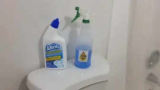

To clean my shower curtain liner, I used the following:
** Use in a well ventilated area. I had a high volume fan going.
  1. Purchased the picture item at a dollar type store for about $1.25. (The product contains sulfamic acid.)
  2. Mixed it in a ratio of 1:1 with water (the bottle with the blue colored liquid.)
  3. Sprayed the scale/soap ridden shower curtain liner
  4. Let soak for about 5 minutes
  5. Spray off with water or use a plastic cup and splash it on to wash residue down the tub drain
I now do a light misting after each shower.
The final cleaned shower curtain liner.
