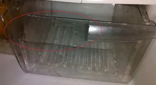

We can't afford a new fridge. See below, half of the bin handle tore off. Manufacturer doesn't sell replacement bins for our 8 year old fridge. They said we must replace whole bin, not just the handle.
Fridge storage bin with broken handle

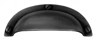

Any furniture drawer pull that fits can be fastened to the front of the bin. You could even try to match ones already used for your kitchen drawers.
Here is a cup-shaped one with three screw fasteners, for example:
cup-shaped drawer pull
When you drill holes through the plastic bin for the drawer pull fasteners,
put a wide stiff brace behind the screws
to make a 'sandwich' to reinforce the plastic which has become brittle.

You can either
  • Add a handle by making two small holes and thread a piece of rope through or
  • Cut a grip hole either as a notch at the top or a full hole a bit lower, large enough to comfortably grip the drawer.
The former leaves the drawer structurally whole, but depending on material the rope can be a problem when cleaning and potentially harbor mold, the latter weakens the drawer more and you need to ensure the remainder is stable enough even with a fully loaded drawer.
Depending on how brittle the material is, I would either drill/saw or melt the required holes. Use the broken off bit to experiment.
Long-term, acquiring a new drawer is probably the best option. Consider also second hand sources.
