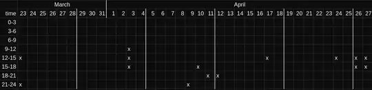

Update April: I've started taking more notes about the details of this humming.
It cleanly turns on and off, there is never any difference in pitch or volume, no variation, slow start or ending or anything like that. So it is almost definitely some kind of machine that causes this.
The hum usually plays for 1-5 hours, at various times of the day and week. Here is a table that shows some of the occurrences (but probably not all, since I sometimes wake up with it already playing, sometimes already listen to music with headphones and don't notice it, sometimes am simply not at home, etc.):
hum timings
The top column is actually empty because I've never heard it after midnight. The next ones are empty because I'm rarely awake at those times. The others are somewhat complete.
The hum often plays for hours at a time, but often (especially after it had been permanently on for a while) it turns off for a few seconds to minutes, then on again for up to a minute, then off again and so on.
