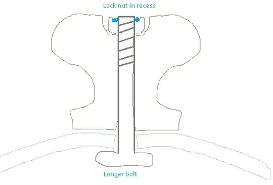

I think you'd be better off doing it differently. How it is right now, it fell apart for a reason; you're not solving the reason by just packing the hole. Instead I'd:
  • Use a drill to extend the hole right the way through the knob
  • Use a larger drill to create a recessed hole in the top of the knob
  • Use a longer bolt and locking nut, that goes right the way through the knob, with the locking nut in the recessed hole
Caius Jard
  • 2,759
  • This won't work because there isn't enough of a post. It only sticks up maybe 1/2", probably more like 3/8". - good idea under a different circumstance though. - I appreciate the diagram! – CryptoFool Feb 07 '21 at 17:25
  • "use a longer bolt" - i.e. replacement of any existing post, but if you can find a nut that screws onto the existing post then see if you can drill a deeper recess into the knob. A picture of what you have would also help.. – Caius Jard Feb 07 '21 at 17:32
