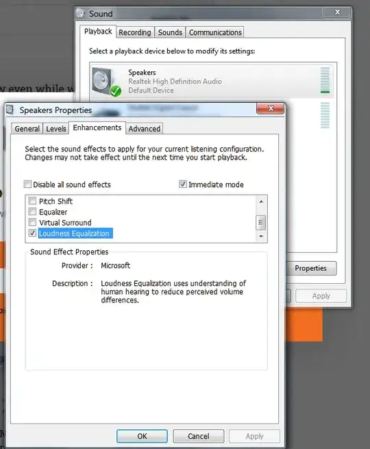

If you have Windows with a Realtek Audio driver, there is a setting for Loudness Equalization.
Loudness "equalization" was the MS term. Such that increasing the volume above a certain point does not affect the output volume for a given sound source. There are individual volume sliders for each application in the "Mixer" as well as external speaker amplifier options to choose the best " loudness equalization" levels overall.
You may notice a boost when this is enabled, which is normal then you would reduce the speaker level to suit your needs.
  • I believe this will have the opposite effect to the one the OP desires. The problem is that there are unwanted loud portions of the audio which must be acted upon. As noted in your last statement, dropping the level will further reduce the volume of normal voices to make loud segments bearable. – Stan Feb 07 '21 at 17:59
  • Compression works raising the gain of lower than loudest sounds which have lower gain in order to equalize not the ducking effects of your impression or clipping or AGC pumping effects – Tony Stewart EE75 Feb 07 '21 at 19:57
