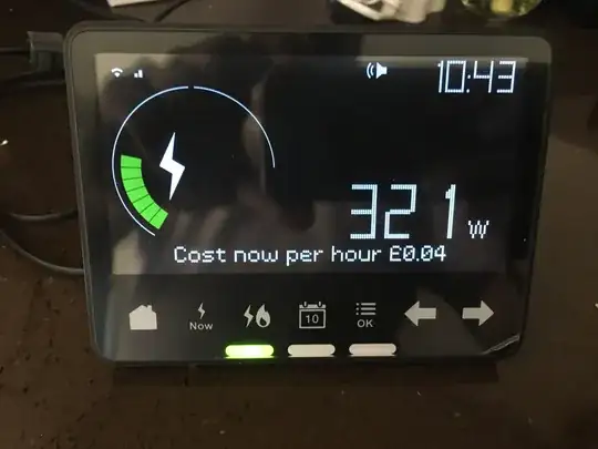

An alternative to method 2 in the answer by @WeatherVane
If you have a smart meter for your electricity supply, you can monitor the power usage using the smart meter monitor.
The monitor in the image below, as you can see is reading 321 watts when the correct screen is selected.
You can see what electricity is being drawn at any time using these monitors. Just look at the power draw before and after switching the heating on. If the power draw is 2.5KW more when switching on, you know your heater is working as it should.
