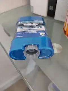

I tried to use a brand new deodorant, and turns out it's stuck: it's just not possible to turn the wheel in the bottom of the deodorant in order to push it upwards. The wheel is jammed completely and does not turn at all.
This is how it looks like:
image of deodorant
The wheel/circle in the bottom is stuck, and can't be turned.
Is there any way to use the deodorant anyway? Would be pity to throw it away.

  • Do you mean that the wheel is jammed completely and does not turn at all or do you mean that you can turn it but it does not advance the plunger that pushes the (gel)? deodorant out of the top of the stick? If the latter, can you look through the case (or peel a label off) and see if the threaded rod up which the plunger rises does or does not turn when you turn the wheel? – Caius Jard Jan 13 '21 at 15:17
  • @Caius the first option. Added to the question. Thanks! – Shadow Wizard Love Zelda Jan 13 '21 at 16:07
  • Might also be a silly question, but have you tried turning the wheel both ways? I can't remember which way these turn to expel the gel - it's been many years since I had one – Caius Jard Jan 13 '21 at 16:35
  • @Caius yes, and it should be clock-wise. – Shadow Wizard Love Zelda Jan 13 '21 at 18:11

If the stick is stuck to the sides of the container, you could try one or more of these to free it:
  • Remove the cap and tap the stick against a hard surface.
  • Submerge the whole stick (with cap on) in warm water to soften the plastic, and then either
  • ... try the wheel again, or
  • ... flex the tube to try and break the adhesion.

It looks like the container is made out of plastic, so it can be cut easily.
The following hacks may work.
  1. Cut the container and fill the gel in an empty cream or petroleum jelly box, something like this.
So you can use your fingers and apply in armpits just like we take cream out of such box.
  1. Or cut the container and fill the contents into empty glue sticks or lipstick boxes.
But this may require using more number of such glue sticks/lipsticks or store the entire contents in another container and refill them more frequently.
This method would be time consuming, you can apply the deodorant on a smaller area but still it may work.

I pulled out the bottom wheel using some force along with the gear that isn't working. Wrapped plumbers tape / plumbers hemp around the gear. Stuck it back. Now the gears are taking and doing it's work as it should.
Werner
After experiencing the same thing, I found a solution by breaking off the wheel with a pocket knife, don't cut yourself, the wheel is very sturdy, then pushing the bottom stick in the opening slightly upwards with the blunt end of a pencil. I refused to resort to scraping out of the container everyday, haha. It doesn't slide back in when you apply it, either. I hope I saved someone's day.
