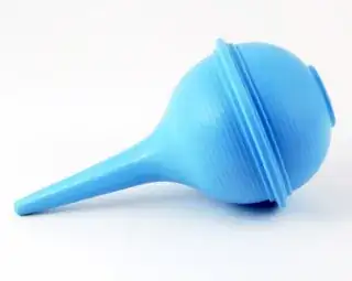

Use one these blower things to get those niches
blower
