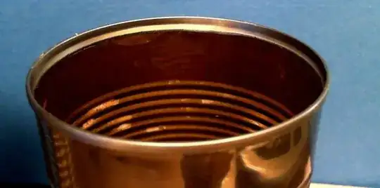

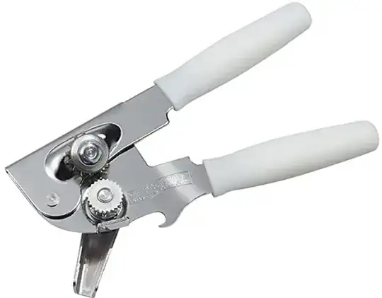

When using cans that have a conventional top that is opened with a can opener like this:
Picture Source

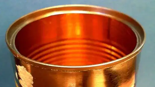

I end up with a very nice top edge of the can that is easy to get parts into and out of. Here is an example of a can like that:

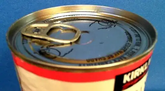

Unfortunately more and more cans these days have this type top that is removed using a pull tab:
The pull tab cans end up with an annoying lip remaining around the rim of the can as you can see here:
The typical can openers that I have tried are not able to cut out this annoying lip because the cutting wheel on the opener is unable to reach down far enough to engage the lip.
My question here is looking for how to conveniently remove the lip in a manner that leaves a nice edge like what is left on a conventional can after opening?
The method needs to be easy to use and not leave sharp edges. I have dozens of these annoying cans and would like to make it so much easier to get parts into and out of the cans.

  • I use a normal can opener to remove the offensive edge. Of three I tried, all of them work to remove the pull tab top as well as "normal" ones. Try another brand of opener. Bring a clean can to the store to try before you buy? The one you have may be uniquely incapable for your chore. – Stan Jun 07 '20 at 13:50
  • @Stan - I have already tried four different models of can openers that have the cutting wheel with the gear behind it (like shown in my question). None of them come close to doing a satisfactory job removing the lip. Some did nothing and others only achieved in bending the lip down. – Michael Karas Jun 07 '20 at 15:23

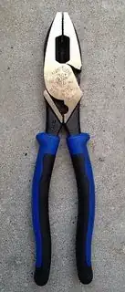

I wanted to see if my idea of pressing the lip in would work, so I opened a can, emptied it and looked for my favorite pair of pliers.
Snipe-nosed pliers
These are not it, but they would have to do.

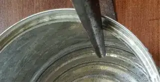

Can with pliers on lip
My first attempt left a not so pretty folded lip and so I pressed slightly while bending the pliers towards the center of the can.

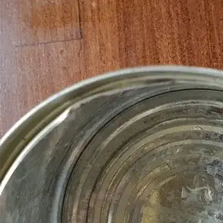

Can with bent lip
The result doesn't look very pretty with these pliers, but the can is safe to handle.
Can with bent lip
As you can see, I've left parts of the lip untouched for comparison. There are no sharp edges left even if the picture says I did an awful job! My pliers are too narrow and I'm sure a pair like these, would make a nicer finish.
