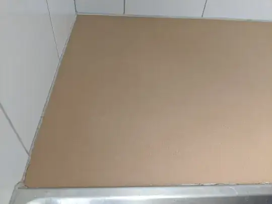

Unfortunately, I haven't been cleaning up this wet residue after each use. As a result, the surface that the microwave was sitting on has developed a white stain. The microwave has lived on both a piece of wooden furniture and also a laminate benchtop, and both have developed these white stains.
Stain on laminate benchtop
This one is faint, but if you look closely near the bottom section, you can see lots of little pale white patches.
White stain on laminate benchtop

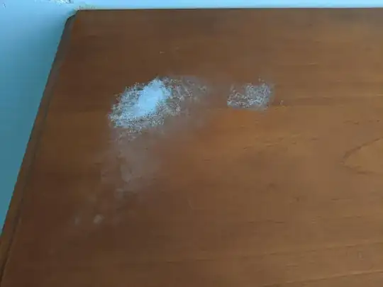

Stain on wooden furniture
White stain on wooden furniture

The way I understand the pictures is that whatever you see is not a stain at all. The material of the furniture has wore off - i.e. it was removed due to all the humidity, heat, cleaning...
The if this is the case, then you have few solutions.
  1. Replace the element. Contract a local furniture making company, they might be willing to help.
  2. Live with it. If it is not (very) visible - maybe hidden under the microwave, then there is no harm in just forgetting about it.
  3. Apply an adhesive foil on top of the board, with any model that you choose - wood, marble, metal... Be careful that this foil might not be suitable for high temperatures - study the situation carefully first.

The second picture, the wood looks varnished, which will bloom if subjected to repeated steaming. Is the wooden top actually veneer or solid wood? It looks like permanent damage [bloom] to the varnish, which may now be penetrated, allowing limescale buildup in the wood-grain itself, making it a compound issue. I think that's a job for a sander & a new varnish… assuming it's even solid wood & not veneer, which is likely too thin to stand much sanding.
You might gain some slight improvement by treating with standard descaler [long soak for maximum penetration], then oiling or waxing the surface. That may mask it but not fix it. If the varnish is badly bloomed then removal is the only real fix.
