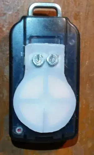

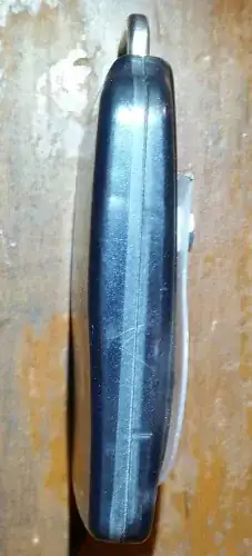

I got fed up with this and made a cover for the fob. Its just a piece of subtly-curved plastic hacked out of a milk bottle, to vaguely match the curve of the buttons.
The bolts are little M3x0.5 and were about 5mm long.
I opened the remote with a screwdriver in the top, under the metal keyring loop. The circutboard was just wedged in place.
The bolt heads are on the inside because they were smaller than the nuts, but I still had to shorten them with a dremel to allow the case to click closed.
The range of the transmitter seems unchanged, I didn't alter the board at all. You can still press a button through the lid, but it needs a lot more "push".
Longer term I'm thinking of a complete 3D Printed case which is minimised to just the circuit board, but that's future stuff. It would have either a sliding or a flippy lid over the button.
