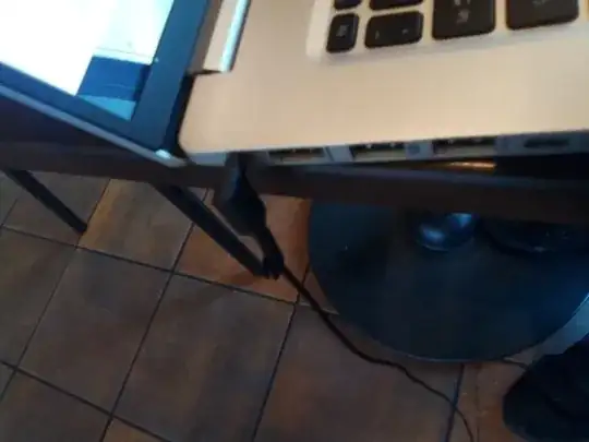

Here is a pic of the view from the outside:
Note how the plug "hangs down". The hangy-downy part will often bump the side of a table that I have the laptop on. This is just one example of random accidental stress that gets applied to the port.
How can I physically support my plug port when my laptop is charging, in a relatively unobtrusive way?

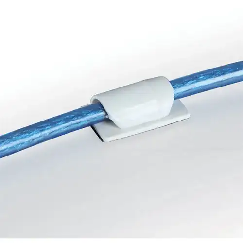

You could attatch a glue-on cable clip to the laptop and secure the cable in it.
Something like this:
enter image description here enter image description here enter image description here
The clip's inner diameter should be the size of the power cable so it sits tightly. That way the power plug always sits in one direction and pulls on the cable are partly dampened by the cable clip.

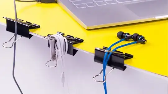

A simple binder clip is 'portable.' It can fit anywhere in your daily carry.
First, turn the elbow-shaped plug 90° right or left so the weight of the cord can 'rest' on the desk surface beside the laptop.
Slide a simple binder clip onto the edge of a table near the laptop power receptacle. A turn or two of the charger cord wound around (rather than through) the wire 'handles' takes the stress off the vulnerable plug.
binder clip as cord keeper
Good luck.
