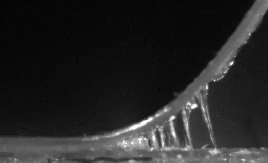

The glue on very old tape has quite likely gone dry and brittle, and lost its adhesive property.
But when removing any adhesive tape, label or sticker, peel it off very slowly (start in a harmless area) to give the glue a chance to separate without tearing the thing it's stuck to, or what you are peeling off. The glue may be stronger than either, initially, and by peeling slowly it gets a chance to stretch and separate into filaments, which individually are quite thin and eventually break.
