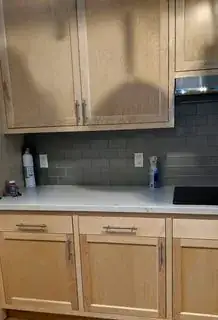

Here is a photograph of a typical counter in our kitchen:
kitchen counter with cabinets above and below
The answers to keeping cats out of open loft and other cat-related questions are not relevant, since this is specifically about detecting cats on a counter, not cat-proofing a space or what negative reinforcement to provide.

  • One place to begin is to stop leaving food waste on the counters - see left hand side. – Weather Vane Nov 05 '19 at 08:47
    Ellen, just to clarify (before answers go in all different directions): is your question about how to keep the cats off the counter (which may encourage all kinds of hacks), or what tech solution could detect cats (which is probably not a good fit for this site and should/could be migrated to one of our sister sites). For the former: Did you know that there’s also Pets SE? I bet you are not the first nor last cat owner with the problem and checking there may also be interesting for you. – Stephie Nov 07 '19 at 06:48
  • @WeatherVane There is not food waste on the counter. – Ellen Spertus Nov 08 '19 at 04:33
  • Sorry, it looks like a folded banana skin and an empty can. – Weather Vane Nov 09 '19 at 19:23
    You need more than something which can only indicate/detect presence or absence, without preventing specific behaviour. Your pets have already learned how to avoid the deterrent you've purchased (with their own integral pressure detectors for weight). No matter what the detection is, you'll still need to find a compatible deterrent. – Stan Nov 11 '19 at 14:01
  • @WeatherVane If you zoom in, you'll see a pen and a cork. – Ellen Spertus Nov 11 '19 at 23:32
