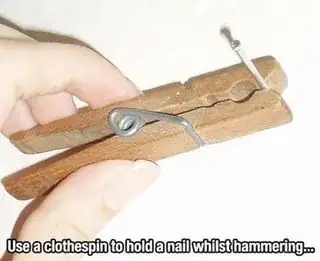

40
To make sure you don't hurt your fingers, you can use a clothespin to hold the nail in place.
Image from Pinterest
This is very safe and probably more effective than using your fingers.

35
There's clothespin trick, but that one is almost a meme at this point.
