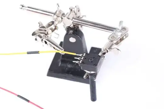

If I get you right, you are looking for something like this:
You can find this kind of thing if you search on Google "clamps for soldering wires" (as I did). They may have a better name, but do not know it.
virolino
  • 2,640
  • Great. You know what I am looking for.
    Now to build it. The swivels are a good idea. I am open to using metal as well. I have wing nuts and bolts and can :-) @virolino
    – fixit7 Jul 02 '19 at 07:19
    They are often known as "Helping Hands". There are many different varieties available and they are normally very cheap to buy. – Lefty Jul 02 '19 at 10:41

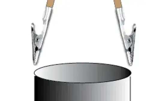

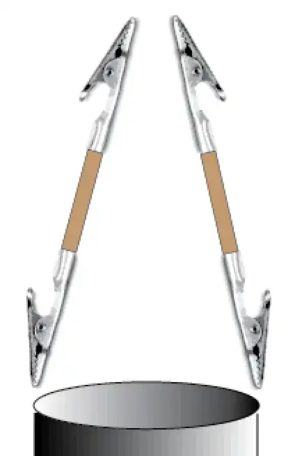

Here're INSTRUCTIONS describing HOW TO MAKE something to hold small parts stationary as per your request and by using the materials pictured.
  1. Break the dowel into 3 inch pieces.
  2. Jamb each end of the dowel into an alligator clip. Make a couple. Fixit7 Clip
  3. Use the clip on the bottom of each piece to hold onto a base
    such as a clean empty tuna fish tin with the top removed with some weight put inside for stability.
Fixit7 Clip base
  1. Use the clip on the top of each piece to hold onto your thing.
    The alligator clips can be rotated on the dowel for positioning.
    The dowel position can be altered by positioning the bottom grips.
Fixit7 Clip exploded view
