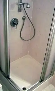

While showering I notice that the drain starts to clog and water start to accumulate, but yet its not totally clogged. What can I do to prevent further clogging, while still being able to continue my shower?
Original uploader was Alexander.stohr at de.wikipedia Later versions were uploaded by Wiska Bodo, Austriaboss, Wikipeder at de.wikipedia
I have a separate shower that happens to have a drain that clogs easily. I try to remember to put drain cleaner into it regularly but I sometimes forget. Also the shower gets used by people with long hair.
I've tried holding the shower head directly to the drain, but that did not change anything. I tried adding soap and shampoo but that did not work either.
I don't have drain cleaner currently and can't go buy some in the next days as the shops are closed where I am, so the drain needs to be open for the next few days (~5 showers).

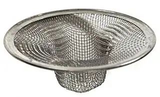

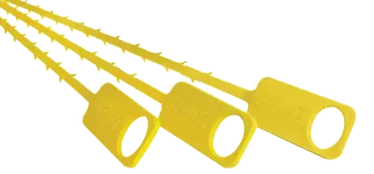

To unclog the drain from hairs use ZIP-IT
Just insert it into the drain, wiggle it little bit and pull it out with all the nasty stuff, repeat until clean. To prevent the drain from clogging again put a drain strainer in the drain. enter image description here
