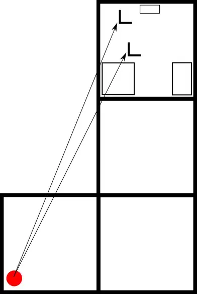

I want to be able to connect to my wifi network from downstairs in the garage. My apartment is three floors up, and, while the signal is detectable there, it's very weak.
I have tried lifting the laptop up higher. The reason is depicted here:
How can I extend the range of my wifi router?

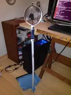

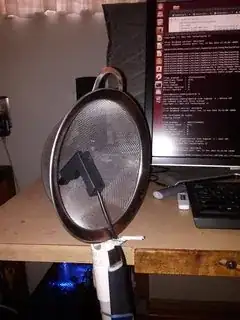

I've had a ton of luck by building a little 'dish' on the receiving end using a mesh colander and a USB WiFi adapter.
I've used this to get on the neighbours WiFi while waiting for the new internet to arrive:
the one I rigged up with the stand
Obviously, mine is very temporary. A much nicer and more permanent one could be made.

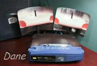

  • Aluminium Can Signal Booster.

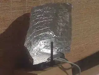

    • Using kitchen foil:
      1. Use aluminum foil. This will reflect the wireless signals from your router.
      2. Check your speed/Mbps and keep note of the number that is displayed (I.E. 72.2 Mbps).
      3. Tear off a sheet of foil that is around the size of normal printing/copying paper (8.5 x 11 in.).
      4. Curve the sheet of foil. If you want to make it easier/quicker, just wrap the sheet around the label area of a 2 liter soda bottle, and hold it there for about 5 seconds. Unwrap it and it should be curved.
      5. Place the curved sheet of foil on its side (where it's standing up horizontally) behind your router.
      6. Check the Mbps/speed. It should be faster than the original speed before you placed the foil behind your router.
      Aluminium Foil Signal Booster
      photo and solution by @wifi_guy

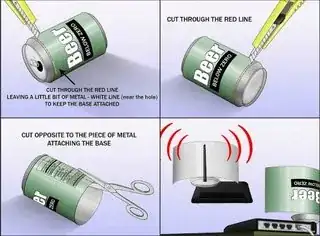

    • Using beer can. Read more: How to boost your WiFi signal with a beer can (7 Photos) Aluminium Can Signal Booster

Use a sheet of aluminum foil behind the antennas. By using foil, you will reflect the signal going away from your devices back toward your devices.
However, since your goal is to transverse multiple levels of floors, this won't be very effective. Instead, get a wi-fi repeater. If you have -- or a friend is willing to give you -- an old router, there's a good chance it can be setup as a repeater, perhaps on the second floor.
if you're unable to obtain a repeater or place it on the second floor, and the tin foil trick doesn't help, your remaining option is to buy a more powerful router.

I notice that the appartment is two floors above the router. Because of the way the radio signal is emitted from the antenna, almost none of it goes straight up if the antenna is vertical. (One trick to visualise where most of the signal goes is to imagine a donut threaded onto the antenna. No signal at the ends of the antenna, but all around the sides, good signal.)
This means that you must point the side of the antenna towards the direction in which you want to have the best signal. In this case, that would mean setting up the antenna so it's almost parallel to the ground.
This will work with any router which has a positionable antenna. Plus, it's free!
A note about multiple antennas: place the antennas at 90 degrees from eachother, in a "V" shape, to get the best overall coverage, since each antenna will be covering the other's "dead zone".

According to this picture the access point is on the floor, if possible place it near the ceiling and put a metal sheet or aluminium foil under it (the sheet should be bigger than the AP). Instead of metal sheet you can use alluminium cup for backing or something similar
