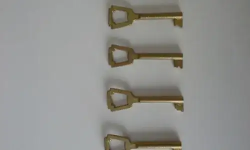

The key is of this type:
keys
I have no experience of, nor tools for lockpicking. Any ideas?

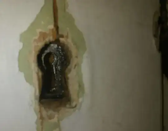

Edit: I was not able to open it yet. I am adding pictures of the actual door and lock:
keyhole door with hinges, keyhole, and doorknob

  • We really need a picture of the lock and the door. Not just the key. Not being familiar with US English, I'm not sure what you mean by 'closet'. Is it built into the wall or is it free-standing? – chasly - supports Monica Nov 30 '18 at 11:38
  • The door hinges are designed so that the door would be removed by opening it and then lifting it off the hinges, rather than by removing the hinge pin. The lighting of the picture is not very good, but the appearance is consistent with either a crude warded lock or a crude lever lock. Does the keyhole extend all the way through the door? If so, and you can get a dowel the right diameter to serve as the shaft of the key, you might try putting a small finishing nail in the side of it (maybe an inch from the end), extending out about as far as a key would go, and then... – supercat Nov 30 '18 at 16:16

  • I don't suppose that's an actual picture of your missing key, that you took in anticipation of this exact problem, is it? If so, then you might be able to fabricate a new one from the photo... – A C Dec 01 '18 at 07:58

    Now that a picture has been added, it's clear that the type of hinges used do not have pins that can be removed, but this is still and answer that could help someone else. – JPhi1618 Nov 30 '18 at 15:17
    I'm pretty sure I could get the pins out of those hinges with a Dremel equivalent and a hammer, but you'd need new hinges afterward. – Zeiss Ikon Nov 30 '18 at 15:58

Vintage locks employed two concepts, sometimes individually and sometimes together.
A warded lock has structures within the lock, called warding, which are designed to fit in notches carved into the key. A quality warded lock will be constructed so that the only way for a key to reach the mechanism is for it to snake around some complicated warding, but many cheaper warded locks can be opened with a skeleton key, which is a key blank that is filed down to remove everything except one or two simple projections or pairs of projections that will operate the mechanism. The way to defeat a quality warded lock is to construct a key by starting with a suitable key blank, covering it with soot or similar material, attempting to open the lock, moving the key back and forth a little at the place it is blocked, carefully removing it, and looking for markings in the soot. Cut, file, or otherwise remove the parts of the key where the soot was marked by the warding and try again. Either the lock will open, or new markings will appear, which again need to be removed. This process can sometimes be slow and tedious, but one will end up with a usable key, greatly increasing the value of the lock to a collector.
Lever locks have one or more levers that must be lifted to the correct height to allow the bolt to move. Lever locks will often have a different feel from warded locks, since warded locks will usually block the key before it has a chance to engage the mechanism, while lever locks will allow the key to engage the mechanism but will block the mechanism from moving fully unless the levers are lifted to the correct height. Many lever locks can be picked relatively easily with the proper tools, but picking would require using a pair of tools, with one being used to try to operate the mechanism which is blocked by the levers, while the other tool is used to try lifting the levers. Often, there will initially be one lever blocking the bolt; once that lever is moved to the right position (i.e. "set"), the bolt will be able to move a little bit before being blocked by another lever. If the bolt is kept under tension, this will rather conveniently hold the first lever in place while the picker focuses attention on the next lever that needs to be set.
The best locks combine these two approaches, requiring intricately-cut keys which need to move several different levers simultaneously by relatively precise amounts. Such locks are much more expensive to manufacture than current designs. Although they may be as secure or even more so than most recent locks, the additional security they offer is not sufficient to justify their cost.
I would not expect a closet door to have a particularly high-quality lock. If the lock uses warding to distinguish correct and incorrect keys, picking with crude tools may be easy. If it uses levers for that purpose, picking will require the simultaneous use of two tools that are designed to work together. There are many youtube videos and web tutorials that would explain how to make the required tools. If you can find some old keys that look like they would fit, I would suggest trying them and seeing what happens. If the key is blocked by something in the lock without engaging a mechanism, you probably have a warded lock. If the key engages the mechanism but the mechanism itself feels blocked, it's probably a lever lock.

Several things in your favor with this door:
  • It's old, dry wood, easy to break
  • The hinges aren't particularly secure, and possibly made of a cast metal
  • The door frame is not substantial
Options, in no particular order:
  • See if the fancy molded (ogee style) wood around the large center panel can be removed; on most doors of this style this wood is a thin strip nailed to the body of the door on one or both sides of the door, or its a decorative strip covering a thin lip that retains the panel. Removing the strip allows the entire center panel of the door to be removed or it exposes the thin lip that can then be easily broken. See https://en.wikipedia.org/wiki/Frame_and_panel for more info on door construction and how you might use a hammer and chisel to remove the molding securing the center panel: enter image description here
  • Use a hacksaw horizontally to saw along the center line in the hinge, cutting the pin, then pull the door off. Fit new hinges. You might need to cut into the frame slightly as you make your way through the hinge: enter image description here
  • Use an adjustable wrench to grip the hinge. The wrench should point vertically with the side of the wrench touching the door. Use a pipe slid over the wrench handle for extra leverage. Fit new hinges enter image description here
  • Chisel a square out of the door frame that the lock bolt fits into - there will probably be a small strike keep plate to stop the wood frame getting rubbed by the lock mechanism. Remove enough frame to extract the entire thing. Here's a strike plate in a door frame for an idea of what I mean: enter image description here

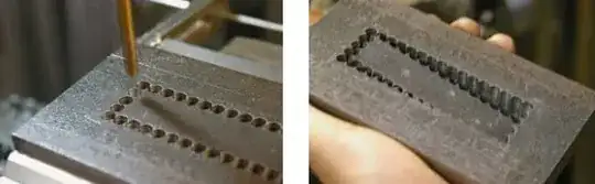

  • Chain drill(slow) or use an angle grinder with metal cutting disc(fast) the deadbolt protruding from the lock. If chain drilling, drill small holes closely spaced then larger holes. Drilling a small hole will act as a guide for a larger hole. Drilling a larger hole that overlaps with the next large hole effectively cuts through the deadbolt. Chain drilling technique: enter image description here
  • Similar to chain drilling, using an angle grinder with cutting disc will achieve a very fast result, but it's worth mentioning that angle grinders are often reckoned to be one of the most dangerous power tools a person can own. Cutting discs are about 1.5mm thick and will fit down the gap between door and frame to make short work of cutting off the protruding part of the lock. They would also go through the hinges in a matter of seconds. Being so thin, the cutting discs can shatter if abused and at 11,000+ revolutions per minute can end up flung far and wide. If cutting hinges horizontally beware that the door will drop as the hinge is cut through, gripping the sides of the cutting disc; that's when it will shatter. Prop the door underneath by hammering a wedge between the floor and door. The risk of bodily injury is high if you have no experience with an angle grinder; beware. Angle grinder with cutting disc: enter image description here
  • Neither the door, frame, hinges or screws are particularly substantial. Using a pry bar to force the door open will likely be successful. Use of a flat bar will be easier than a typical round bar. The door frame will require some easy repairs after: enter image description here
