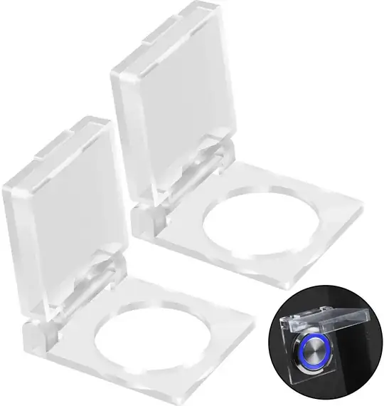

There exists a cover that prevents most young kids from accidentally touching nd powering down the PC. It only works for certain types of power buttons though (the round ones). I was hoping someone made one of these for my PC's square power button.
picture of the power button cover
