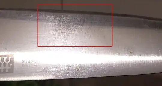

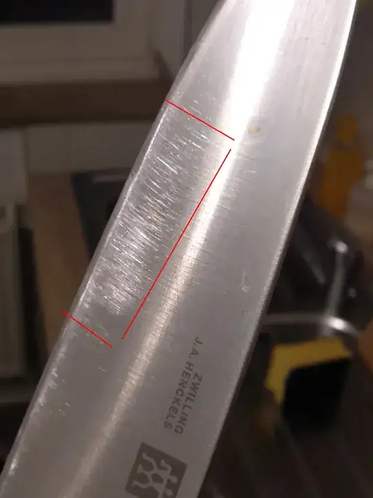

I have a large cooking knife with a smooth blade. While sharpening it with a grindstone, I did a too low angle and scratched the side, like this:
Knife with scratches
This part of the blade now stick to tomatos and onions in an unpleasant way. I would like to smooth this out without damaging the knife any further.
Can I do this on my own or should I had the knife to a professional knife sharpener?

What I have seen from knife sharpeners, I would try it myself rather than going to them.
Use the softest tools you can find. And prepare for a long and slow process, to avoid further scratching.
What you need to use depends on the metal of your knife, but the list starting with the harshest you may need reads:
  • fine grained sharpening stone used with oil.
  • Copper or silver polish or tooth paste, (possibly with a mechanical buffing method.)
  • (green) scourer sponges with oil rather than water.
  • leather with very fine sand.
  • the jeans of the trousers you wear.
You do not need to do all in one go, you can do sessions between using the knife, as long as you are careful washing off all the metal shavings and the oil you used while working. Add a new coating of oil when putting the knife away. My grandmother used to always wipe the table knives with pumice, which while not as fine is as soft as you can get in stone.
If you get into that same habit with this knife, in the longer run the scratches will disappear. (Instead of pumice you can also use the (green) scourer pad.)

  • I can see from the photos that this knife is hollow ground. No rigid tool will get the scratches, unless it's the same curve as the hollow in the blade. – Zeiss Ikon Jan 10 '18 at 18:39
I have been a professional knife sharpener for many years and the most upvoted comment here says don't go to a professional? And use your jeans and oil stones?
Wet/dry sand paper the whole secondary bevel, not just the damaged spot. Start at 400 grit go up to at least 800 then from there it's your finish preference or you could move up incrementally until you match the finish on the rest of the blade. It takes time. Move in one direction for each step to create a crosshatch and you're done. It costs like 5 bucks.
