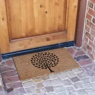

Method 2 - Doormat
By placing a doormat on the longer edges of doorway threshold, for the robotic vacuum cleaner, a small step will be available to climb. Theoretically, this method should work for Xiaomi robot vacuum if doormat height less than 2cm and doorway threshold height is less than 4cm.
Doormat
