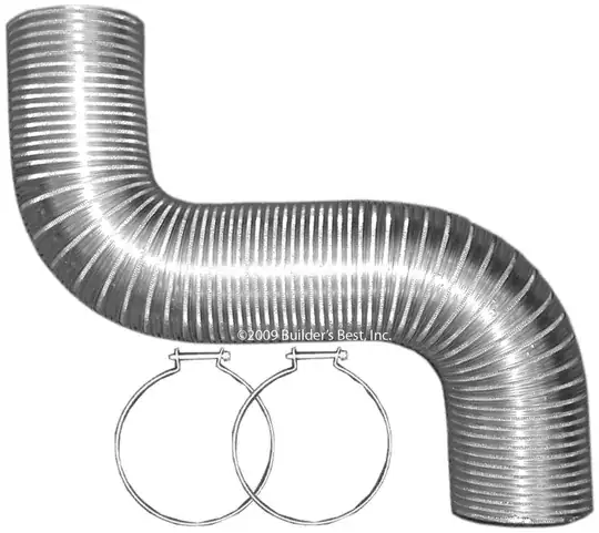

You could try semi-rigid dryer ducting:
dryer ducting It's still flexible, more durable, and only slightly more expensive. This is more than just tinfoil. Besides being stronger, it may also deter them due to the harsh tactile nature of it.
In dryer months (no pun intended) this can act as an electrical ground, too. I've seen cats playing on a carpet get statically charges, then go near an outlet to get zapped. Hilarity ensues (for the human).
If there's any significant amount of heat going through these, I'd stay away from the packing tape @Robert Cartaino suggested. The packing tape could melt and/or start a fire. Putting the tape as a barrier (without actually touching) to getting access to these might be an option, though.
computercarguy
  • 780
    The O.P. kind of ruled this out in his question: "Replacing the flexible ducts with metal ones - not possible, the ducts are running through some tight spaces and bend very often, and I'm on a limited budget." – BrettFromLA Nov 08 '17 at 19:17
    This is still flexible and not significantly more expensive. This can be bent in the same ways as the plastic and tinfoil ones, except for the really tight turns that should be avoided anyway for airflow reasons. – computercarguy Nov 08 '17 at 20:48
  • @BrettFromLA even flexible ducts are metal - OP implied rigid metal ducts are not an option, which makes sense considering the effort of snaking them both through tight spaces. –  Nov 09 '17 at 04:38
    This looks like it could work. I've seen these tubes in the past but did not realize I could use them. – JohnEye Nov 09 '17 at 16:07
  • @computercarguy The first time I read the OP's question, I just read "metal ducts". But you're right, he did say the problem was that they (RIGID metal ducts) wouldn't be able to snake around. He would need to pay to replace them all, and he's on a limited budget, but it probably wouldn't cost much - and it would solve his kitty problem! – BrettFromLA Nov 09 '17 at 17:18

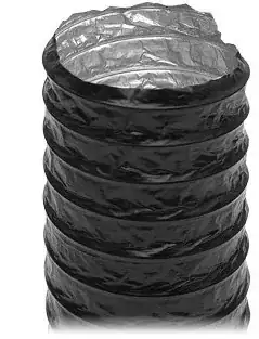

Replace the flexible ducts with insulated flexible ducts. If they rip the outer plastic, they will only hit the insulation and not create an air leak. You can tape up any holes without compromising the integrity of the inner duct. It's essentially a tube inside of a tube with insulation around it.
Insulated Flexible Duct R6
Alex
  • 3,979
  • 25
  • 45
Dotes
  • 141
    OP would have to use a smaller diameter inside tube, restricting the air too much. Also, this would only slow the cats down by an insignificant amount of time as they continue to dig into the soft sides. Cats will dig through insulation. – computercarguy Nov 08 '17 at 20:50
  • As @computercarguy said, this is not a good idea. We have some ducts which look like this and guess what, the cats actually love the additional material to play with. – JohnEye Nov 09 '17 at 16:06
  • @computercarguy the inside tube won't need to be made smaller, you match up to the interior tube not the exterior one, – Harper - Reinstate Monica Nov 10 '17 at 06:14
  • @Harper, the OP said it was a tight fit in places, so the outside diameter would have to be small enough to get into the same places. This means the inside tube would have to be smaller to accommodate the extra insulation. – computercarguy Nov 10 '17 at 16:42

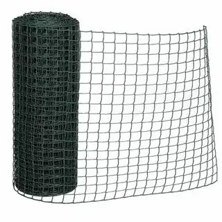

Plastic trellis from the local hardware store will solve the problem.
It's cheap and easy to use.
It can be easily cut with normal scissors and still sturdy.
We use one with a 10mm square hole to hang flexible duct (donkey dick in the trade) all the time.
