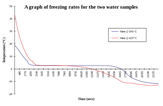

1. Use hot water as your starting point.
Exploit the Mpemba-effect:
Since there is some debate about the effect, whether it is real or not: the greater the exposed surface area, like in a lake were the effect was discovered or the apparent application from the question, the stronger the effect seems to be.
