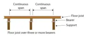

If you are directly above a crawlspace, you can add some support for the beam (bearer) supporting the floor joists under you. In the illustration, the centre beam would be the problem spot to check.
Floor cross-section showing supports, and floor joist
The best material to use is concrete cement blocks piled on top of each other to support the common wall separating your apartment from Casanova's. There might even be a support already there where the shims (grey part on top of supports) have become displaced. The support might have dropped, become dislodged, or be missing.
A car jack can boost and hold the beam temporarily while you fit the last parts of the support column into place before you lower the floor.
Try increasing the height about an inch the first time you jack up the floor. You can use dry wood shims for thicknesses less than concrete blocks.
Did it work? If it isn't perfect, Casanova will help test your work and you can modify the amount of support until it's solid and doesn't move during the most amourous activity.
It's not complex or hard. The heaviest thing will be a concrete block, one at a time. Take your time. Good Luck.
