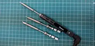

I would like to be a able to grip my soldering iron closer to the tip to have better control of what I'm soldering.
As asked, here is a picture of the soldering iron, it's an chinese TS100: Small soldering iron

I guess I would need to place a good insulator around the hot metal to be able to do it. A great insulator that would resist the heat?
I found the insulator Pyrogel XTL, maybe it could be wrapped around the tip.

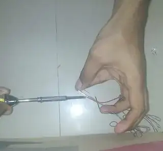

This is how to use soldering iron. With practice u will be comfortable to do soldering jobs with very little chance of burning u r finger. I learned this method from BigClive

Fennekin
  • 473
    The user5507535 did not ask how to use a soldering iron. The question was how to grip the soldering iron closer to the tip. – Stan Aug 27 '17 at 19:04
